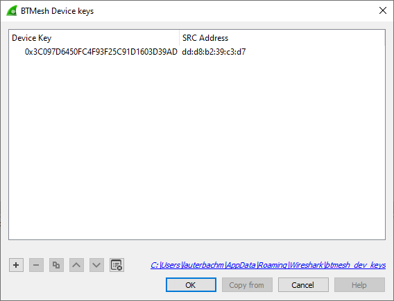

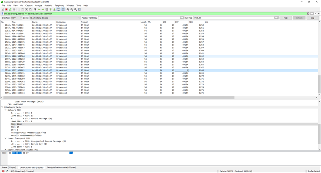

I am preparing sniffing workspace for BT Mesh, where I have 3 devices in the Mesh network (provided by nRF Mesh app) and I need to read SRC, DST, SEQ and simmilar values from the packets. I am using Wireshark and after setting Network key, Application key and Device key I was able to read mentioned values, see screenshot: https://ibb.co/tHQdZwx
But when I removed node which is inspected in the screenshot from the network and added again, SRC, DST, SEQ values are not available even after I set up new Device key in protocol settings.
Is there something I am missing? Some button I have to press to apply new protocol settings?
