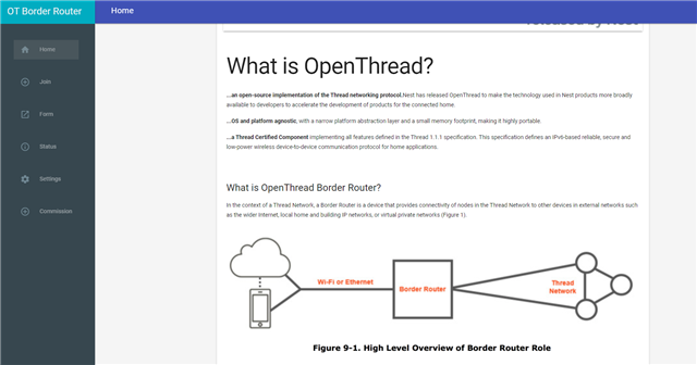

  • The web inteface is the one that can be reached at the Router IP address:
    The router I'm using is the one provided by Nordic (I followed instructions here: Border Router.
    All I did was to form a new network using the tab "Form". Commissionig works fine: the cli on the device running the mqtt-sn example shows the correct thread parameters. Only thing is that it cannot find a valid mqtt gateway.

  • Perhaps you have some old network configurations in one of the chips. Try to call "sudo wpanctl status" and compare it to the network data on your mqtt-sn device.
    Either way, I suggest you completely erase the flash on both devices (using "nrfjprog --eraseall") and re-flash them, so that you know that neither of the devices have any old flash garbage before you start the projects.
