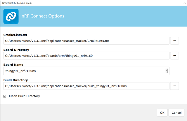

    • Open SES from the Toolchain Manager and choose the followin settings:
    First time I run this I got a "Did not finish cmake", however I did it again with the same settings as above and it worked. I'll look into why this is.

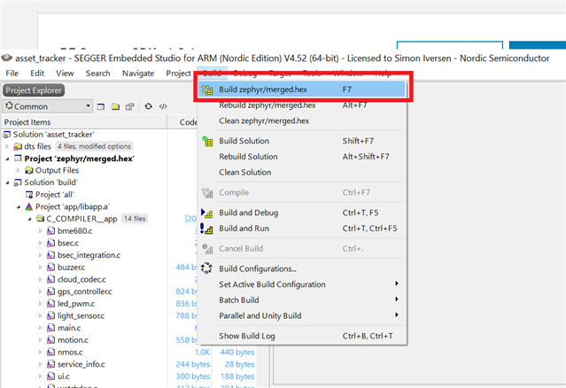

    • Next build the project:
    That worked for me.
