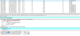

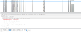

I want to advertise as broadcaster (not peripheral and also not as a beacon). Advertising packages do not have the information nonconnectable and even if I am using
m_advertising.adv_params.properties.type = BLE_GAP_ADV_TYPE_NONCONNECTABLE_SCANNABLE_UNDIRECTED;
it is still seen as connectable (I checked by the nrf connect desktop by using another devkit). I am using 52840 and soft device 7 via sd_ble... commands. Also a service is added with its UUID but no characteristics exist in the service.
What are the conditions that the observer understands (or assumes) that the advertising device is peripheral (connectable) or broadcaster (nonconnectable)? Or in other words, what is this type BLE_GAP_ADV_TYPE_NONCONNECTABLE really doing?
My confusion is that the advertising package does not hold any information. The first line is for example is simply the AD flags telling about the limited/general discoverable or Bluetooth classic is supported or not. But there is no info about connectable vs. nonconnectable.
