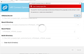

I cannot load project in Segger Embedded Studio - emProject file is invalid
I am having problems loading an existing project that I successfully built and ran in the past.
I open IDE from nRF Connect > Toolchain Manager > Open IDE
The SES opens with the last project (different from the one I would like to load) running on the nRF5340pdk.
I then do File > Open nRF Connect SDK Project... > select the CMakeLists.txt for the project I want to load.
I get the error below. I then deleted all the files in the build folder but the error would not go away.
Any idea what could be causing this?
Thank you for your support.
Mohamed

  • Are you using the v1.3.0 version of the light controller sample? The tutorial has recently been updated. What happens if you build with west? Does it suceed then?

    Yes, I am using version v1.3.0.
    As I already said in my post, I successfully built and ran this project in SES very recently but I went back to it today it came back with that error. I prefer to work in SES if I can help it.
    I tried to build in west but it came back with this error.

    C:/Dev/NCS_projects/light_controller/src/main.c:54:8: error: unknown type name 's16_t'
    54 | static s16_t m_sample_buffer[BUFFER_SIZE];

  • I see that you are not using a Zephyr version compatible with NCS v1.3.0. From the logs I see that you are using Zephyr version 2.3.99. The correct one should be v2.3.0-rc1-ncs1.
    If you have installed NCS manually, do this:
    cd <..>/nrf
    git pull
    git checkout v1.3.0
    west update #Comment: This will get the correct Zephyr version
    The easiest solution is to just install NCS v1.3.0 in the Toolchain Manager and open the git Bash shell directly from the Toolchain Manager, then everything is set up automatically.

    When you open SES from the Toolchain Manager, you should set the Board Directory field to point to a board from the Toolchain Manager Zephyr folder.
    Let me try to explain in another way:
    If you open SES Toolchain from Toolchain Manager NCS v1.3.0, you should choose the following Board Directory:
    C:\Users\<user name>\ncs\v1.3.0\zephyr\boards\arm\nrf5340pdk_nrf5340
    It did not seem like you did this in your initial post (given that you haven't changed the Toolchain Manager SDK directory).
