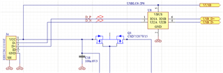

  • The event APP_USBD_EVT_POWER_READY should trigger when you power up the VBUS pin. Is this on a custom board? How do you handle the VBUS pin?
  • Yes, it is connected to USB connector. Diagrams below.
