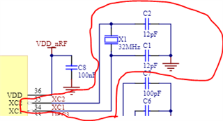

as I said before I am working with nRF52832. I can connect with nrf and program it. for example I can make an LED to blink. but when I run the esb_ptx example the program doesn't pass through the clock_initialize() line. I am using the CX2016DB32000D0WZRC1 chip as the crystal. can you help me to find the problem.

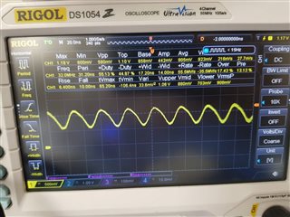

    The input signal is too high, try with a ~300 mVpp signal instead. A too high signal won't break it as long as it's within rails but will clip or distort the signal.

  • Hi, now, crystal is oscillating with the NRF but the problem is that the nrf can not pass through the loop which indicate that the HFCLK is running, I mean the loop below:

    what can cause this problem? the signal that I am seeing in the oscilloscope is:
    I know that the probe may reduce its amplitude, but even without the probe it can not pass from the loop.
    The loop waits for the HFCLKSTARTED event, which has the following condition: "A HFCLKSTARTED event will be generated when the HFXO has started and its frequency is stable.". So we need to look more at your crystal circuitry.
    One potential issue we have not discussed before is that C22 shard ground with DEC2 and DEC3. This could be enough to affect the clock. Can you try to connect C22 directly between pin 1 and 4 on the crystal?
