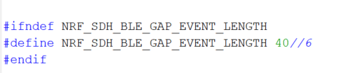

  • I suggest setting NRF_SDH_BLE_GAP_EVENT_LENGTH to 40
    I did this but it seemed to make no difference.
    After changing this, you will likely need to allocate more RAM to the SoftDevice
    Also I did not require to do this. This was my RAM start address before as well as after changing the above value to 40: '0x20003F38'

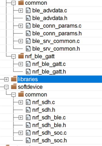

  • ble_conn_state.c
    ble_advertising.c
    ble-> components, I use the following files:

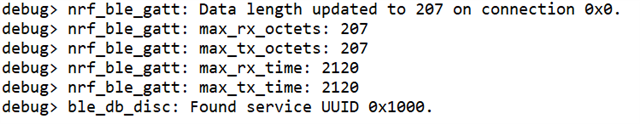

    You can set NRF_LOG_DEFAULT_LEVEL to 4, and when the DLE is updated, you should see this in the log:
    <debug> nrf_ble_gatt: Data length updated to 251 on connection 0x0.

    Yes I did increase the value to 207 (exact size=3+4+200bytes of data) on the master and that enabled DLE exchange which wasn't happening earlier. Now this happens even without calling nrf_ble_gatt_data_length_set(). The GATT module apparently automatically updated the Data Length. However, in the peripheral NRF_SDH_BLE_GAP_DATA_LENGTH is still set to 251.
    Yes, I've already done that and get this
    Master
    Peripheral

    Are you still getting NRF_ERROR_RESOURCES ? Did you try to increase NRF_SDH_BLE_GAP_EVENT_LENGTH to value higher than 40?
    No, I didn't but I'll try doing it. It should be within minimum and maximum connection interval right ?

     Try with NRF_SDH_BLE_GAP_EVENT_LENGTH . The buffer is also indirectly increased by increasing NRF_SDH_BLE_GAP_EVENT_LENGTH.
    You can set it higher than that.
