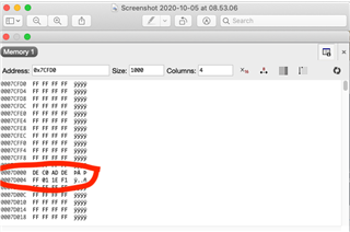

How to prevent the application project to write to a defined memory segment
H,
I am using the SDK 15.0.0 and Segger Embedded Studio for ARM V3.40.
I have been successfully defining a flash memory section for data exchange between the bootloader project and the application project.
The flash memory section is the following
btldr_app_exchange R 0x0007D000 0x1000
Currently the bootloader project can write to this memory section. The problem I am facing is that the application project writes at run time to this very memory segment at the address 0x0007D000 to 0x0007D007(below)
When I define a different memory segment (btldr_app_exchange R 0x0007D08 0xFF8) the exact same behaviour is observed (the application project writes at run time at the address 0x0007D000 to 0x0007D007 and only at this address)
1/ How can I prevent the application project to write at as given memory segment?
2/ Is the address x0007D000 to 0x0007D007 specific and shall not be used to exchange data between the bootloader and the application?
For the moment, I have decided to exclude address x0007D000 to 0x0007D007 from my memory segment (btldr_app_exchange R 0x0007D08 0xFF8)
Thanks in advance for your support.

    The flash area that is written to here is an FDS page (Flash Data Storage). Is your application using FDS? Perhaps the peer manager is included? Search for fds_init() in your application project.
    Why do you want to keep the application from writing to this page? In case you are using the FDS either directly, or indirectly (through the peer manager) you would want that module to access this area.

    So I guess the peer manager uses FDS with 3 pages, and not 1, as you pasted here? You need a bare minimum of 2 for FDS to work at all.
    The custom flash area, m_btldr_app_exchange_data_fs, do you intend to use fds for this as well? Or "bare metal" fstorage? In case you consider fstorage, are you familiar with the way that updating flash content works? (you need to erase an entire page before you can write to an address that is already written to).
    Is there a reason for why you don't put the custom flash area next to the one used for FDS?
    My suggestion for you is to just use FDS for everything, and keep the default settings of 3 pages.The peer manager has reserved all records with file IDs from 0xC000 to 0xFFFE.
    This means you can use file IDs 0x0001 to 0xBFFF. It is perfectly fine to have two instances using the same FDS area. The records are organized by FDS, and you can write, update and delete records. FDS will take care of positioning, updating and garbage collection (moving valid records to a new page, and deleting the old ones).

    Marlene said:
    I am probably missing something, but why would you assume, from the information I gave, that the peer manager I defined would use FDS with 1 page only?
     Because you mentioned NRF_FSTORAGE_DEF(nrf_fstorage_t m_fs) with .start_addr = 0x0007F000 and .end_addr = 0x0007FFFF (this is one page = 0x1000 = 4096 bytes).
    fds.c doesn't specify these addresses directly, so I assumed you had changed these. Please correct me if I am wrong here.
    fds.c's definition of NRF_FSTORAGE_DEF() in sdk 15.0.0 looks like this:
    NRF_FSTORAGE_DEF(nrf_fstorage_t m_fs) =
        // The flash area boundaries are set in fds_init().
        .evt_handler = fs_event_handler,
    the .start_addr and .end_addr is set dynamically dependent on whether there is a bootloader present or not, inside flash_bounds_set().
    Please note that the bootloader will typically be located between 0x78000 and 0x7DFFF:
    So if you have a bootloader you should not use the 0x7D000 area.
    If you also have FDS, you should also not touch the area that is set between .start_addr and .end_addr that is set in flash_bounds_set(). The flash pages after .end_addr is used by the bootloader, so you shouldn't use these either.
    I don't understand whether your
    is fetching data that the bootloader writes (by default, and not something that you have added yourself), or if it is custom data. If it is custom data, then you should place it below the FDS pages that you are using. That is, the page directly below FDS' .start_addr.
    In your: // Reached if the page is erased or CRC is wrong
    please consider what happens if something goes wrong here. E.g. if you erase the page and then loose power (which may happen if your battery is running low and this is running close to the start of the application. You can expect some gliching of the input voltage). What happens if this is reached and the page is blank or corrupted? This is why we recommend FDS, because it will always write the new record before invalidating the old one. But it may be fine in your case.
    To "protect" a flash area, please look at how the bootloader does this:
    ret_val = nrf_bootloader_flash_protect(BOOTLOADER_START_ADDR, BOOTLOADER_SIZE, false);
    Remember that you can't delete the flash area here if this is called. Also, to make sure that the bootloader doesn't touch this area while performing a DFU, make sure that you set DFU_APP_DATA_RESERVED to the number of pages that you want to protect from the bootloader.
    Edvin
