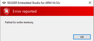

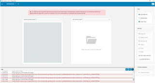

  • Ok after replacing a mux that was ded on my custom production board, i can flash with nrfConnect programmer the four files with succes and the program run fine. I still have issue in debug mode with SES.
    I can connect to jlink, but i click on run degug, i get an error :
