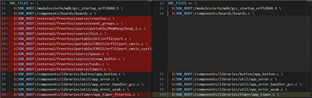

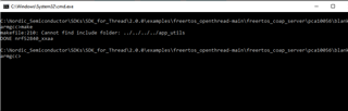

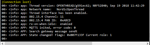

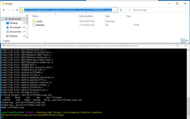

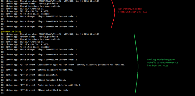

    One thing i noticed, when trying to run the working project without FreeRTOS in the project directory of the FreeRTOS program (modified coap server), and with the FreeRTOS makefile, the program would not run with the FreeRTOS makefile, despite not using any FreeRTOS functionality.
    I did not get a hardfault error, but other than that the program responded as the FreeRTOS program, not receiving any MQTT-events. However when i tried removing the FreeRTOS-files from the makefile, just from the SRC_FILES as shown below the program works.
    The right file is the working makefile.
    The program flow. First running the makefile on the left, then running the makefile on the right.
    It seems that just including the FreeRTOS source files, without including or using them in the main-file,in the project causes the MQTT-events to stop responding.

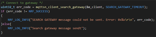

    We believe the issue is that your function calls are using a lot of timers, which are not supposed to be called until you have kickstarted the FreeRTOS itself using vTaskStartScheduler().
    Basically, you can't use any of this:
        thread_instance_init();
        mqttsn_init();
        /* Connect to gateway */
        uint32_t err_code = mqttsn_client_search_gateway(&m_client, SEARCH_GATEWAY_TIMEOUT);
        if (err_code != NRF_SUCCESS)
            NRF_LOG_INFO("SEARCH GATEWAY message could not be sent. Error: 0x%x\r\n", err_code);
        }else{
            NRF_LOG_INFO("Search gateway message sendt");
    before you call vTaskStartScheduler(). Please note that the vTaskStartScheduler does not return, so you need to add these parts e.g. within your openthread task.
    Without being able to pin point exactly what caused the Hardfault it was definitely a timing related issue. The reason it worked in SES was probably due to optimization. When I compiled the DEBUG variant of the project, it hardfaulted, just like your armgcc project.
    I don't know exactly what it should look like, but look at the unmodified freertos_coap_server example, and do only one change at the time. If it stops working, then look into why it doesn't work.

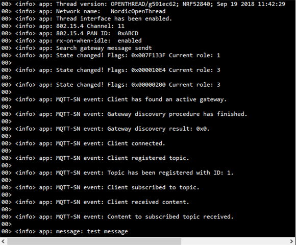

    Thank you for the reply!
    Moving the mqttsn_init() function and code for connecting the gateway into the task, i.e. running it after the vTaskStartScheduler(), fixed the problem and the program works! I found moving the thread_instance_init() function to the task caused the program to crash.
    So now everything seems to work!
