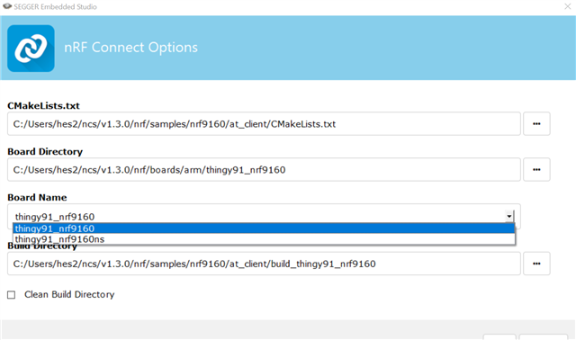

1. Thingy91 was not present in ncs/zephyr/boards/arm, which is where I was directed by the Getting Started Assistant
Workaround: I copied the thingy91_nrf9160 from ncs/nrf/boards/arm folder as I found this posted as a workaround. However, I don’t see the standard and “ns” (secure and non-secure) variants as was shown in the Getting Started Assistant.

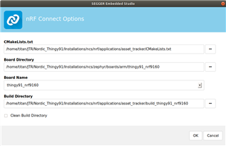

3. I can’t build a project from the sample applications at ncs/nrf/applications.
Procedure: File > “Open nRF Connect SDK Project” > target “ncs/nrf/applications/asset_tracker/CmakeLists.txt” for CMakeLists.txt> target “thingy91_nrf9160” in the folder outlined in #1 for Board Directory > Board Name = thingy91_nrf9160 > Build Directory is the same directory as the sample application
Result: A JavaScript Alert giving a Cmake Error at “/home/titan/JTR/Nordic_Thingy91/Installations/ncs/zephyr/cmake/kconfig.cmake:217”
