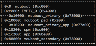

nRF9160: where does the flash partitions address are been picked?
I just enabled the CONFIG_BOOTLOADER_MCUBOOT=y for serial LTE modem application to understand the flash partitions and to perform the serial DFU(not sure if its really supported), but i was confused seeing the rom_report, the build system disregarded the partition addresses defined in the DTS files and overwritten with different start address and sizes, could you help me understand where there partition defined?
i refereed the following documentation but couldn't get the answer.
http://developer.nordicsemi.com/nRF_Connect_SDK/doc/latest/nrf/ug_multi_image.html
http://developer.nordicsemi.com/nRF_Connect_SDK/doc/latest/nrf/scripts/partition_manager/partition_manager.html
regards
KK
