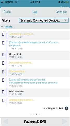

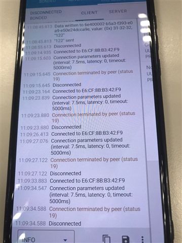

  • Hi Simon,
    Thanks for your reply.
    b) I have test nRFConnect like below:
    [Android] In the test scenario, the logs show "Connection terminated by peer (status 19)
    [iOS] In the test scenario, the logs show Attempting to connect, and seems no timeout.
    Because peripheral keeps connected then disconnected.
     iOS
    I think two different behavior because of design between iOS and Android, right?
    If the bonding data of peripheral has been deleted, App should handle this case right? such as  "Keep the status disconnected" Then user can forget the peripheral in Phone setting.
     Yes, iOS and Android will behave somewhat differently in a few scenarios, this being one of them it seems. The disconnection reason (status 19) is called whenever the peer is the device initiating the disconnection (defers to 0x13 = GATT CONN TERMINATE PEER USER). So there isn't a way to specifically know that this is the issue when you're struggling to connect.
