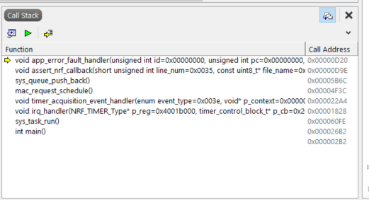

I'm currently implementing the 802.15.4 stack using the precompiled library inside SDK 17.00. I'm trying to send data every tot (10/20/30) ms. What I currently found is that if the time is too small (less than 15 ms), the entire application go in fatal error here:
Is this normal? Is this limitation due to the implementation of the entire stack? Could I manage to increase the throughput using the nrf-IEEE-802.15.4 radio driver inside SDK for Thread and Zigbee or the behaviour will be pretty the same?

    Based on your screenshot it doesn't look like DEBUG is defined in your preprocessor definitions. Can you try to add it, and see where this app_error is coming from?
    Perhaps the timeout is too short compared to the prescaler.
    That being said, 802.15.4 is not built for throughput. The driver will listen for activity on the given channel. If it detects activity right before it will start to transmit, it can't interrupt it, so it is not necessarily better to use the drivers from the T&Z SDK. But look into where your error is coming from. Perhaps it is not related to the radio driver at all.

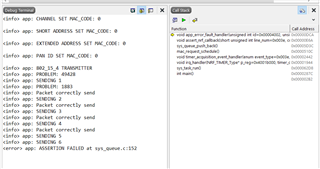

    I add the DEBUG preprocessor definition and what I manage to obtain is this:
    As you can see from the picture, the routine (timer_acquisition_event_handler) in which I call mcps_data_req is correctly called only 6 time: it is like I can't be able to push in the queue more than 2 packet. Moreover the packet (5) is correctly sent (I used the iEEE802.15.4 Sniffer), but in that case the mcps_data_conf primitive in which I print "Packet correctly sent" it is not called. This behaviour is pretty randomic, but no more than 100 connections ever happen (before the fatal error).
    Any suggestion? Is there a way to control is the queue is empty?
  • Where is "packet correctly send" being printed?
    I would say that either way, you should wait for the previous packet to be successfully sent before you send the next packet. If the previous packet was not sent correctly, or if you get an error, try sending it again after a while.
    I don't know if I would recommend this radio driver for something commercial. The Thread and Zigbee 802154 driver is more thoroughly tested, and also maintained more properly. It is at least worth looking into.

    I follow your advise and I found that delay between tx and rx with IEEE 802.15.4 MAC library from SDK 17.00 is not exceptional for this use. So I will dive into the IEEE 802.15.4 radio driver. Any advise on how I can create a SES project from zero?
