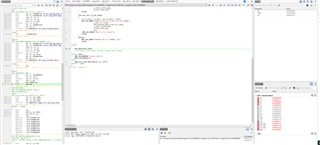

    I don't see how you generate the app_button_event_generator() callbacks. Where is it triggered? I  assume it is one of the parts that you removed inside app_button_event_handler().
    If you have connected a debugger (or you are using a DK), are you able to debug and step through code? It is not trivial once the softdevice is started (in ble_stack_init()), but you should be able to set breakpoints and see whether they are hit or not. If you are doing BLE activity you need to reset the application after this.
    Typically if the application stops, it is because of one of the APP_ERROR_CHECK(err_code); If you are using one of the later SDKs, the log should print something like "Fatal error." Do you see that? If so, try to define DEBUG in your preprocessor definitions, and check what the log says then. Let me know what IDE you are using if you are not sure how to set preprocessor definitions. Also, let me know what SDK you are using if you don't see any error handling in the log, but you do see the log. If you don't see any logs at all, let me know what IDE and SDK version you are using, and also, please show me your sdk_config.h file.

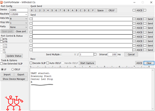

  • Hello, Edvin!
    Thank you for your help.
    I am working with Segger and SDK v17.0.0 and s132.
    NRF_LOG_INFO is not printed on the serial terminal. So I used printf instead.
    Added more code for app_button and attached sdk_config. If this code is executed, the BLE communication will be fine until the button is pressed.

    When the button is pressed, the text output and buzzer must be output. However, the buzzer does not output and the text output stops halfway.
    (Press the button and the text will not be output to the end and will stop halfway.)

    If I continue the debugging line by line, the error codes 'NRF_BREAKPOINT_COND' and 'error' app: SOFTDEVICE: ASSERTION FAILED' will be printed.

    However, you do get log information from your terminal, according to your last screenshot. It is the lines saying softdevice assertion failed.
    The reason you see the "SOFTDEVICE: ASSERTION FAILED" when you continue to debug is because the softdevice misses timing critical events when you break. After you break, remove the breakpoint, try to set a breakpoint another place, and reset the application:
