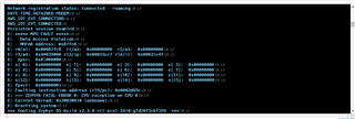

    So after retracing my steps and the AWS_IoT documentation, I was able to establish a connection with AWS_IoT core but there was a problem. My nrf9160dk was just resetting again and again and I could see the following output on the console:
    Can you please help me figure out why this is happening and how can I debug this issue?

  • Have you edited the sample in any way, other than what the documentation states? Added anything to the sample?
    The GNU Arm Embedded Toolchain includes a tool (arm-none-eabi-addr2line.exe) which you can use to find the faulting instruction on address 0x0002d65c
    arm-none-eabi-addr2line.exe -e zephyr.elf 0x0002d65c
    Where zephyr.elf is found under aws_iot\build\zephyr\zephyr.elf
    You may also find some answers here.
    Are you building for secure or non-secure?
    Øyvind
  • I haven't modified the sample apart from what had been stated in the documentation. Didn't add anything from myself.
    I was building for non-secure.
