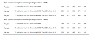

How wide are the peaks? I know that it depends on many factors how high and long the peaks are. Currently we have measured peaks of 450 mA for 40-50 ms in our application. But is there a maximum possible time for the large current Peaks?

Hi Benjamin,
So the time will depend on the modem as it is the one in control for the power use when transmitting and receiving. But a main factor is the network solution, if LTE-M is used or NB-IoT. For NB-IoT the bitrate is lower which means the TX time has to be on for a longer period to transmit the same amount of data that LTE-M would for the same amount of data.
Link to nordic tech webinar (21 October) that will shed some lite on the power usage over time.
Jonathan
