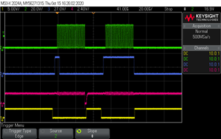

    Now, I'm seeing activities on the SPI signals. I used the nrfx_spim_xfer function to read SPI slave device ID, and it worked fine as follows (some signals polarity is reversed, but it does work):
    (Green is SCLK, Blue is MOSI, Pink is MISO and yellow is the chip select)

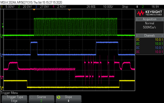

    I think the problem might be that the chip select signal is going high at the end of each nrfx_spim_xfer function call, so the device does not see it as a single action. Are there functions avaliable instead of nrfx_spim_xfer that can control those signals at a lower level? a function to lower chip select, a function to receive bytes, a function for transmit, etc? That will probably solve my issue.

    Also, I think the image of the trace that you shared is a bit strange. Why is the there activity on the MOSI line and MISO line before the clock signal is active. Is there something else driving this line?
  • Seems To work, Thank you very much!
    I'm not sure where the other activity is coming from
