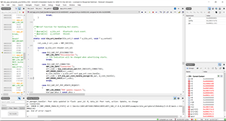

    2-Issue with Custom Characteristics no 5:
    When I add this I got following issue.
     Where exactly did  you add this, and what does it return? Did you add it inside the nrf_ble_qwr_conn_handle_assign()?
    Have you tried looking into nrf_ble_qwr_conn_handle_assign()? Try to debug and see why it returns 8.

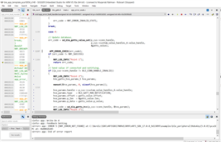

  • What happens when you "write from device side on characteristic no 4"? Can you describe the issue?
    I have debugged code and I have set different printouts and its printing "Point 1" of the following code.
          case 4:
          // Update database.
          err_code = sd_ble_gatts_value_set(p_cus->conn_handle,
                                            p_cus->custom_value_handles_4.value_handle,
                                            &gatts_value);
          if (err_code != NRF_SUCCESS)
              NRF_LOG_INFO("Point 1");
              return err_code;
          // Send value if connected and notifying.
          if ((p_cus->conn_handle != BLE_CONN_HANDLE_INVALID))
              NRF_LOG_INFO("Point 2");
              ble_gatts_hvx_params_t hvx_params;
              memset(&hvx_params, 0, sizeof(hvx_params));
              hvx_params.handle = p_cus->custom_value_handles_4.value_handle;
              hvx_params.type   = BLE_GATT_HVX_NOTIFICATION;
              hvx_params.offset = gatts_value.offset;
              hvx_params.p_len  = &gatts_value.len;
              hvx_params.p_data = gatts_value.p_value;
              err_code = sd_ble_gatts_hvx(p_cus->conn_handle, &hvx_params);
              NRF_LOG_INFO("Point 3");
          else
              NRF_LOG_INFO("Point 4");
              err_code = NRF_ERROR_INVALID_STATE;
    I am adding it in the same way as adding others' characteristics.

  • So what does sd_ble_gatts_value_set() return before it prints "Point 1"?
    I am getting the following issue.
     So why does nrf_ble_qwr_conn_handle_assign() return 8? What check or what function inside nrf_ble_qwr_conn_handle_assign() causes it to return 8? Please try to debug this.
    I don't know how to debug next. Can you please guide?
    I have also attached my project can you please check for once.
     I have tried your project, and I don't get any of the errors that you get.
    Go to the definition of nrf_ble_qwr_conn_handle_assign() and set a breakpoint inside it. When the breakpoint hits, check that the p_qwr pointer is not NULL, and check the value of p_qwr->initialized. What is that value?
