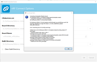

I am using a custom board setup for nRF9160 and I have trouble opening the project. I have got the project from one of our third party contractor.
Here are the version details
SDK v1.3.0
Windows 10
nRF9160
Can anyone suggest how to resolve this.

This configuration is not defined in NCS (not in 1.3.0 and not in master either). The reason for this is that the PDM peripheral is not configured as non-secure, see the SPM documentation.
It looks like this configuration was added as from the PR #1896 but then removed the day after in PR #2338, because the change caused GPIOTE to stop working on non-secure apps, see this comment.
I will get you some information tomorrow on if and how you can configure the PDM peripheral as non-secure.
