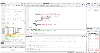

I have written these 3 functions to erase/read and write.
/////////////////////////////////////////////////////////////////////////////// SNV
const uint32_t f_addr = 0x000FF000; // Last page start address 255
// Create a pointer to that address
uint32_t * p_addr = (uint32_t *)f_addr; //cast f_addr to a pointer
uint32_t erase_SNV()
    NRF_LOG_INFO("Memory Erased");
    return sd_flash_page_erase(255);
uint32_t write_SNV(int address,uint8_t value)
    uint32_t val;
    val=value;
    NRF_LOG_INFO("Data Write in Flash");
    ret_code_t err_code;
    err_code = sd_flash_write(p_addr+address, &val, sizeof(val));
    return err_code;
uint32_t read_SNV(int address)
     NRF_LOG_INFO("The Data read from flash is: %d", *(p_addr)+address);
     return *(p_addr)+address;
When I write any value from address 1 it gives following wrong output(0 1 2 3).
    write_SNV(1,11);
    read_SNV(1);
    write_SNV(2,12);
    read_SNV(2);
    write_SNV(3,13);
    read_SNV(3);
  //  read_SNV(0);
    read_SNV(1);
    read_SNV(2);
    read_SNV(3);
But When I start address from 0 it gives the right values.
    write_SNV(0,10);
    read_SNV(0);
    write_SNV(1,11);
    read_SNV(1);
    write_SNV(2,12);
    read_SNV(2);
    write_SNV(3,13);
    read_SNV(3);
    read_SNV(0);
    read_SNV(1);
    read_SNV(2);
    read_SNV(3);
How can I save values in rondom addresses?
Thanks!
