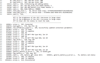

Hi, we tried to implement battery model for hardware and iOS app
for iOS we used 'nRFMeshProvision', '2.2.3' lib
from iOS we execute GenericBatteryGet() and waiting for next one response GenericBatteryStatus but receive UnknownMessage
also the send code from hardware
on the hardware side it's looks like this
I talked to one of our mobile developers, this is what he said:
You need to implement the Battery status message on the iOS as well. The opcode is unknown to the library so it's not implemented.
