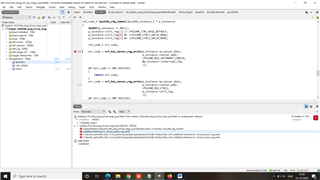

how to read LPS22hb file function ?
I am trying to integrate LPS22hb sensor n nrf52832. I am starting with twi_master_using_nrf_twi_mngr example(sdk15a->compents->drivers_ext->lps22hb)
I have added lps22hb.c,lps22hb.h and lps22hb_internal.h to my the twi_master_using_nrf_twi_mngr example.
ret_code_t hts221_temp_read(hts221_instance_t *       p_instance,
                            hts221_data_callback_t    user_callback,
                            int16_t *                 p_temp)
    ASSERT(p_instance != NULL);
    return nrf_twi_sensor_reg_read(p_instance->p_sensor_data,
                                   p_instance->sensor_addr,
                                   HTS221_REG_TEMP_OUT_L | HTS221_INCR_REG_MASK,
                                   (nrf_twi_sensor_reg_cb_t) user_callback,
                                   (uint8_t *) p_temp,
                                   2);
 I am not sure that what argument use when I call the function. i created the instance and know the sensor address.give below
/* TWI instance ID. */
#define TWI_INSTANCE_ID             0
#define TWI_ADDRESS                 0x5B
#define MAX_PENDING_TRANSACTIONS    5
NRF_TWI_MNGR_DEF(m_nrf_twi_mngr, MAX_PENDING_TRANSACTIONS, TWI_INSTANCE_ID);
NRF_TWI_SENSOR_DEF(m_twi_sensor, &m_nrf_twi_mngr, 128);
LPS22HB_INSTANCE_DEF(m_lps22hb, &m_twi_sensor, TWI_ADDRESS);
i anyone could give me some pointers calling f this sensor that would be great.
