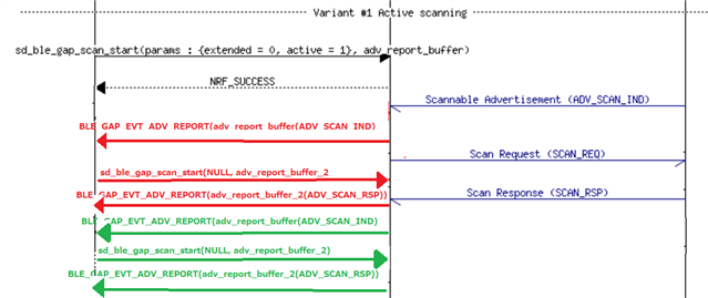

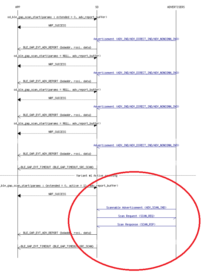

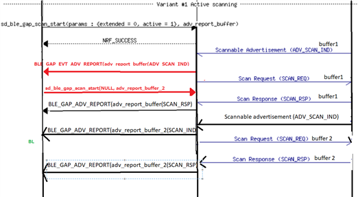

    ADV_SCAN_IND Message Sequence Charts,
    ADV_REPORT is notified only once.
    However, in reality, ADV_REPORT is notified twice (ADV_SCAN_IND, SCAN_RSP). I think the chart is wrong, please tell me the correct time chart.
    Is ADV_REPORT (ADV_SCAN_IND) notified before or after receiving the SCAN_RSP?
