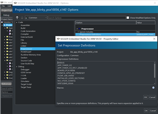

    Could you make sure that you have DEBUG defined in your preprocessor defines, like shown in the included image?

    I ma not hitting app_error_handler and do run with DEBUG (turned it on)

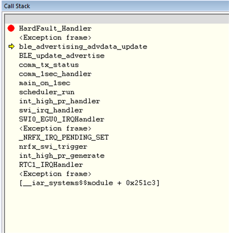

  • Ok
    I got to the root cause of the problem.
    I hit HardFault handler in the function sd_ble_gap_adv_set_configure
    If I call the function from our main loop - I do not hit any breakpoint and everything works smoothly.
    However when I use our regular flow:
    I hit an error. Is there any restriction or when the sd_ble_gap_adv_set_configure is called or context of the caller?
  • I just wanted to state it more clear - if the function BLE_update_advertise is being called at the context of main loop - no problem
  • One more question: by logger you mean rtt viewer right?
  • And one more observation is that when I disabled usage of man specific data at all and just call for the update of ADV data with the same parameters that I initialised at the beginning I still crash - which may be points to the direction of contexts...
    Yes, I too would say this points in the direction of the context.
    What context is the advdata update function called from in your regular program? Could you change the priority of the interrupt that triggers the update, to see if this affects your issue?
