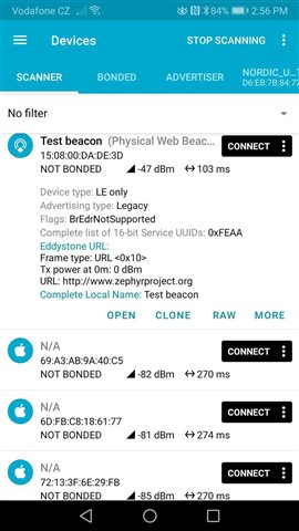

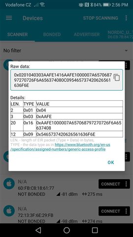

We just noticed that according to the Raw data detail in nRF Connect, we are able to advertise more than 31B data limit. Is that possible or do we incorrectly count the bytes in the advertising payload? This is a way how we do it:
length+ type + payload = xB
1 + 1 + 1 = 3B Flags
1 + 1 + 24 = 26B Manufacturer-specific data
1 + 1 + 4 = 6B Short name
Comes out to 35B in total and shouldn't be valid. However, it seems to be working, see screenshot below.
We are using nRF52833 and 1.3.1 NCS. Relevant code is:

  • You are correct. I got even more confused because I didn't use any scan response in code or even in advertising parameters. See code line below:
    bt_le_adv_start(BT_LE_ADV_CONN_NAME, dt_bt_conn_ad, ARRAY_SIZE(dt_bt_conn_ad), NULL, 0);
    However, when you use BT_LE_ADV_CONN_NAME parameter instead of BT_LE_ADV_CONN, it automatically puts the CONFIG_BT_DEVICE_NAME into scan response.
    Thanks for figuring this out.
