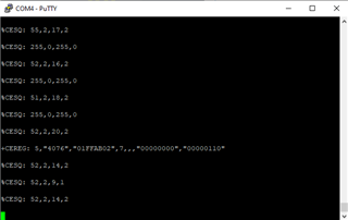

Cant communicate via port - only get +CESQ Answer
Hey There,
The problem I have is the following:
I am able to open a Port via Putty and C# Script. I set it up like I found it in the docs. (https://developer.nordicsemi.com/nRF_Connect_SDK/doc/latest/nrf/gs_testing.html)
With LF and CR implict, with Force on echo and editing, with no Hardware Flow Control...
I do not use RTT right now. With Putty I'am able to see something, but cannot send any messages to the device and with my .cs I cant get anything because SerialPort.ReadLine() never stops and my Raspi waits for Data all the time. I have tried to solve it with a DataReceivedHandler - Method but nothing changes.
If I use the Shell to open the port and send data, the same thing heappens.
I is possible that my C# script is not correct, but with putty should i work and it dosent.
