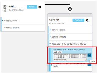

I was able to add our custom service, to assign read and write permissions, the size of the data packet in bytes and so on. We used nRF 52840 Dongle and nRF Connect app to test data transfer through custom BLE characteristics.
Everything is going smooth, we are able to establish BLE Connection, see our custom Characteristic and its properties:
However, when I want to send data from nRF52840 Dongle to our nRF52840 SoC, I am unable to read the data for some readon.
BLE_GATTS_EVT_WRITE event is properly triggered inside our custom BLE Service observer but when I try to extract received data bytes with sd_ble_gatts_value_get() function:

  • I think I resolved the issue. It might be useful for someone in the future so here is what I do when BLE_GATTS_EVT_WRITE event happens:
    case BLE_GATTS_EVT_WRITE:
        if(p_ble_evt->evt.gatts_evt.params.write.handle == p_mercury_service->timestamp_handshake_char_handles.value_handle){
            NRF_LOG_WARNING("Data received over desired custom BLE Characteristic!");
            NRF_LOG_WARNING("BLE Data length: %d", p_ble_evt->evt.gatts_evt.params.write.len);
            NRF_LOG_HEXDUMP_INFO(p_ble_evt->evt.gatts_evt.params.write.data, p_ble_evt->evt.gatts_evt.params.write.len)
        } else {
            NRF_LOG_WARNING("Data received over some other cusotm BLE Charecteristic!");
    with
     condition, I basically check if received data coming from desired custom BLE Characteristic. If affirmative, we can access the data through p_ble_evt->evt.gatts_evt.params.write.data pointer. The length of received data can be read from p_ble_evt->evt.gatts_evt.params.write.len !
