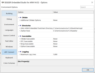

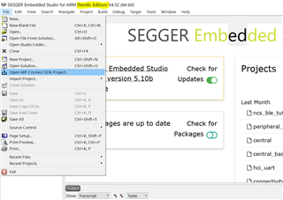

Select File → Open nRF Connect SDK Project… does not exist in option list
  1. Start SEGGER Embedded Studio by clicking Open IDE //Successfully installed, what means Open IDE ? ? ?
  2. Select File → Open nRF Connect SDK Project…  //it just dont appear in the drop down menu
  3. To import a project into SES, you must specify the following information:  I dont understand what to do here ?
    • CMakeLists.txt - the location of the CMakeLists.txt project file of the sample that you want to work with
      i.e. C:\Users\ZIEGER\ncs\v1.3.1\zephyr\samples\basic\blinky\CMakeLists.txt

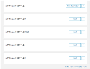

    I suspect you have downloaded and installed Segger Embedded Studio (SES) through their website instead of using the toolchain manager in our nRF Connect software, is that correct? In that case the easiest solution is to uninstall SES and installing SES Nordic Edition again through the toolchain manager in nRF Connect.
    You can download the nRF Connect 3.5.0 software here , Install it, select the toolchain manager, and install nRF Connect SDK with the SES Nordic Edition software through the toolchain manager. It should looks like this:
    and then you should be good to go!

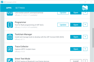

    As to your specific questions:
    1. The "Open IDE" refers to the nRF Connect software, I'll insert a picture to show you how it should look like after installing SES Nordic Edition through the toolchain manager. Open IDE means Open Integrated Development Environment, ie Open Segger Embedded Studio Nordic Edition.
    2 and 3. these options are available only in SES Nordic Edition
