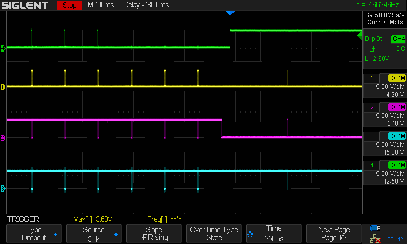

I have an application where the nrf52840 dongle is hooked to a sensor.  The sensor drives a pin high, the mcu grabs data from the FIFO (SPI) and puts it in a buffer.  So far it works great, I see the interrupt pin go high, the device reads the entire sensor FIFO, then repeat.  However, after a while - several minutes, but it isn't consistent - I see the interrupt pin go high, and the mcu doesn't respond.  Since the sensor won't bring the line low until the data are read, the system stops at that point.  I don't see any error, the system is just waiting.  Is this ever expected behavior?  I'm wondering if the idle process is causing an issue randomly?

    From the scope, I see things working great while they work.  When it breaks, I see the MOSI line change high to low well before the interrupt pin goes high.  This seems to indicate that I'm in the idle_state_handle() process, but the pin changes anyway.  Then nothing when the sensor drives the interrupt pin high.  Then I see a reset after a few hundred ms:
    Scope capture
    Like I said, I have measured this at anywhere from 3 to 5 minutes, but it always happens.  Clearly, the expected behavior from my end is that this should work forever.
  • Thank you for the details.
    I had a brief chat with a colleague on this case and he asked why you were accessing the NRF_SPI0 register directly when using the SPI driver? He said this is not recommended and that one should either do everything by using hardware registers, or, one should let the driver take care of things. Using the driver is highly recommended. The driver could be detecting that the IC is in an unexpected state and could cause things to happen.
    Adding the debug-connector to your dongle could be a useful tool for you. Then you might see what state your code is in when things stop working.
