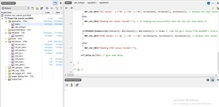

MPU6050 connected with nrf52840dk : not showing anything on terminal
mpu6050 connections
vcc-->vdd
gnd-->gnd
scl-->pin 27
sda-->pin 26
Main.c

i also tried in putty, but nothing is showing in the terminal
any answers, without hesitation ask any question.

    i think based on the code it is uart, then i have enabled RTT and also  NRF_FPRINTF_FLAG_AUTOMATIC_CR_ON_LF_ENABLED , i am not using defferred logger .
     I.e "Logger initialized", or similar.
    i have added this but nothing is showing on the putty or terminal( DEBUG AND TERMINAL EMULATOR)

    i put the same main.c file and followed all the instructions told in the video, there was no sdk file in the description of the video only main.c , mpu6050.c, mpu6050.h file.
    I see now that you are using the twi_scanner example as a base for your application. The example uses deferred logging, which means that you will need to call NRF_LOG_PROCESS() at some point, to have the logs be processed.
    Could you try to define NRF_LOG_DEFERRED to 0, and see if you then see the logger output in your putty terminal?
    Alternatively, you should call NRF_LOG_PROCESS at some point in your main loop.
    Let me know if this resolves your issue,
    Karl
  • Could you try to define NRF_LOG_DEFERRED to 0, and see if you then see the logger output in your putty terminal?
    Thanks, now it is showing the gyro meter values, very much Thank you!!!
