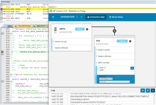

    After those changes, I got an interrupt when I used nRF Connect for Desktop to write to the UART rx service:
    If that doesn't happen in your case, try to debug and see what happens. Does the application crash? I don't have any possibility to help you with projects in formats that we don't support.

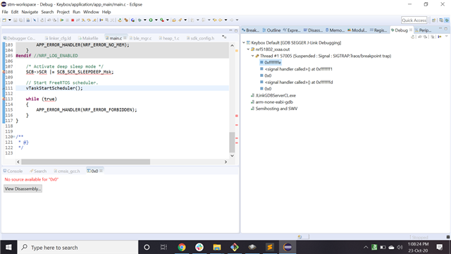

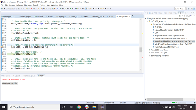

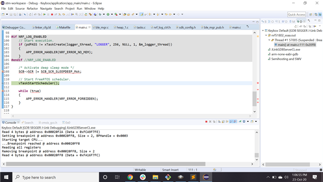

    I want to use freertos in my project so firstly i am running the pre-compiled hex file in the below path and observed that device is not advertising.
    nRF5SDK\examples\ble_peripheral\ble_app_hrs_freertos\hex
    Can you help here?

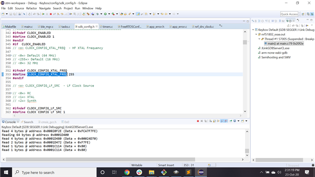

  • Your module probably doesn't have an LFXTAL. You need to compile the project to match your hardware. Change the LFCLK settings in sdk_config.h.
    CLOCK_CONFIG_LF_SRC 0
    and in pca10028.h (or the equivalent file you are using), you need to change the clock settings:
    #define NRF_CLOCK_LFCLKSRC      {.source        = NRF_CLOCK_LF_SRC_XTAL,            \
                                     .rc_ctiv       = 16,                                \
                                     .rc_temp_ctiv  = 2,                                \
                                     .xtal_accuracy = NRF_CLOCK_LF_XTAL_ACCURACY_20_PPM}

  • Sorry. I don't always check the case history before answering a ticket.
    I can't tell whats wrong based only on the fact that the precompiled .hex file doesn't work. Can you please try to compile the project and run it and see if the log says anything?
