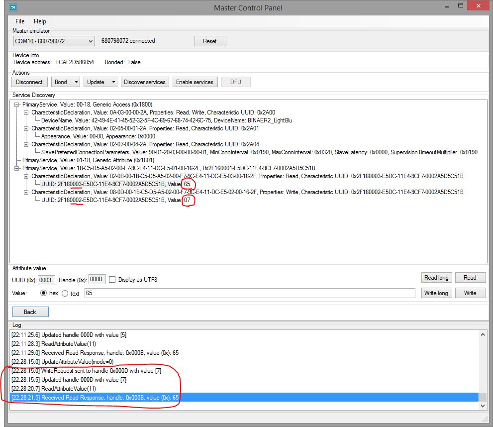

I'm having some trouble with the read authorization giving me weird reply values.
In my application, I'm using a custom service called "Light Control" consisting of two characteristics; one write-only called "Light Command" (UUID: xxxx0002-xx...) and one read-only called "Light Status" (UUID: xxxx0003-xx...). For testing purposes I've set it up so that if I write either 0x05 or 0x07 to "Light Command", then I should get the same value in return by reading "Light Status". This doesn't happen though, as illustrated by the pictures below.
image description
image description
As you can see, the "Light Status" value stays the same regardless of which value "Light Command" was written to.
Can someone please enlighten me (some pun intended) as to what I'm doing wrong?
I'm pretty sure the fault lies somewhere in this code: (i.e in the sd_ble_gatts_rw_authorize_reply parameter setup)

I'm saying this because I've run the code in the debugger, and in all instances the variable update_data is set correctly. That is, if 0x05 was written to "Light Command" then update_data is set to 0x05 and if 0x07 was written to "Light Command" then update_data is set to 0x07.

  • I think I spotted your error now. You have to set the reply_params.params.read.offset.update field to 1, if not it will just send the old value and then update after.
    Could you try that and see if it solves your issue?
  • YES :) That worked! Is this described somewhere? I can't remember reading anything about it in the S110 documentation. Anyway, thanks a bunch!
