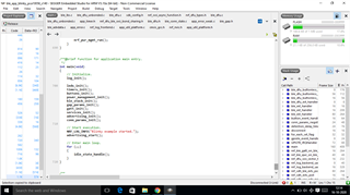

The project is building fine but is not running or working. If I run the software step by step in debug mode then I can see that it ends up running into app_error_fault_handler.
The last function it runs befor going into error handler is ble_advdata_encode() as you can see in the picture below and after the APP_ERROR_CHECK() call it goes into error handler().
I am using "SEGGER Embedded Studio for ARM 5.10a" and  nrf52840dk Rev. 2.0.1.
my main()
What could be the reason for this?
How can I resolve the issue?
