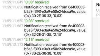

I am using SDK v17 and sending the value of acceleration sensor to the app.
I want to use this value to process some action in the app.  For example, if the transmitted acceleration sensor X axis has a value greater than 1.5, the app will output a notification.
(Firmware might be able to specify the sensor's range of values and send data to the app within a certain range. However, the requirements that I received are to send only the sensor value from the firmware and to be processed by the app.)
So I saved the sensor value in the float array and sent it to the app via nus_data_send.

Can the app developer use this float value in the app?
