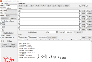

There's something I don't understand about LED timer.
I have a question because there is a problem with writing code using timer.
I wrote the following code to avoid using the LED timer when I first ran it.
However, All_Stop() will not function properly the first time the code below is executed (that is, when the upload or when the pressed reset button).

The timer starts because the charging_state was initially defined as zero, but the timer must be cancelled via All_Stop() immediately after.
This issue only occurs the first time I run it, and it will work normally after that (after a single change in the value of the charging_state).
When checked at the terminal, All_Stop seemed to have been executed properly.
Can you tell me the reason for this problem?

    Please share the actual code you used. Where is the timer configuration and initialization? Which function is used as the timers expiration callback?
    Where is your GPIO configuration and initialization?
    Which function contains the if and else code you have pasted at the bottom?
    Please elaborate on this, what are you seeing and how is it different from what you would have expected?
    Does your All_stop function not work without power-cycling or resetting your device first?
    Your last conditional is inside the if( .. == 0) conditional.
    Is this intentional? With the current design, the last conditional will always be true, when the function is entered with (charging == 0).
    Please review this part of the code, and tell me if this is the intended behavior. If not, could you have meant to place the last part as a separate conditional check?
    As it stands right now the conditional is redundant, since charging is set to 1 right before it is checked.

    I use one internal LED on the board and three external LEDs.
    External LEDs have several operating routines.
    1. When Bluetooth is connected, CenterLED_timers_start() is called.
    (CenterLED_timers_stop() is called before connection).
    2. When the battery charging connector is connected, the three LEDs stop working and print the battery value to the LED.
    3. If the battery charging connector is not connected, the CenterLED Timer starts or stops as shown in 1.

    /*When first executed, Bluetooth is before connection and the battery charging connector is also before connection.
    Therefore, the CenterLED must be turned off. */
        else //no charging
          //charging_state = 0;
          if(charging_state == 0)
            nrf_gpio_pin_clear(BAT_LED_1); //LED Off
            nrf_gpio_pin_clear(BAT_LED_2);
            nrf_gpio_pin_clear(BAT_LED_3);
            CenterLED_timers_start(); //LED1,2,3 toggle repeate timer
            charging_state = 1; //Used to prevent repeated output of CenterLED_timers_start.
            //nrf_delay_ms(100);
            printf("charging_state : %d\n", charging_state); //check charging_state
            if(charging_state == 1) //No LED activity before bluetooth connection
              printf("All_Stop\n");
              //CenterLED_timers_stop();
              All_Stop(); //center timer stop & LED Off
    The reason why I used 'if(charging_state == 0)' is that 'CenterLED_timers_start()' is continuously called when the battery charging connector is not connected. If it continues to be called, the LED behavior becomes strange, so I only printed it once.
    The output on the serial terminal indicates that All_Stop is called.
    But the LEDs are working without stopping.
    (No Bluetooth connection when upload or reset Therefore, the LED should be turned off.)
    Please feel free to let me know if I lack explanation or need anything else.
    Thank you.
  • I'm modified it.
    After further testing, I connected the battery charge connection when there was no Bluetooth connection. CenterLED_timers_start is called when battery charging removed, and the LED turns on.
  • I think it worked out well.
    Changed to operate according to Bluetooth connection status.
    bool pairing_state = false;
            case BLE_GAP_EVT_CONNECTED: //when connected pairing
                pairing_state = true;
            case BLE_GAP_EVT_DISCONNECTED: //when disconnected
    Are you by this saying that the issue is resolved, or are you still experiencing an issue? If so, which issue are you still seeing?
    I suppose here that your pairing_state variable indicates whether the device is in a connection or not. While the name might not be a perfect fit, the functionality and implementation is fine, and should work along the lines of what you described earlier.
    Most examples already does this, using the m_connection_handle variable to indicate if it is in a connection or not.
    From the code you have included you are using some dots, . . . , to indicate that there is some code, but it is not relevant to your question. Please instead share the entire function, rather than a cutout, since this makes it harder to track where the code snippet comes from and where it is called from.
    In general, the code you shared in your previous comment looks much better and more correct than the code you posted earlier - well done!
    Karl
