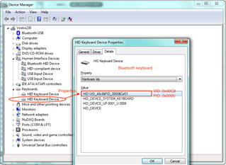

I am developing a composite HID peripheral based on the nRF52840 that can connect to a PC either via USB or BLE.
I am using SDK 15.0.0.
Regardless of the connection type (BLE or USB), the device is supposed to have exactly the same functionality (keyboard + mouse).
Our company has some assistive PC software that relies on identifying the device based on its VID and PID, in order to access the correct functionalities.
We would like to have that both interfaces (USB, BLE) expose the same VID / PID pair.
My problem is: how / where can VID and PID be configured on BLE?
While it was quite easy to find where to define the VID and PID for the USB connection (APP_USBD_VID and APP_USBD_PID respectively in sdk_config.h), I couldn't find where the same values are defined for BLE.
In the Device Manager of the PC I see that when connected over BLE, the device exposes VID = 0x40C8, PID = 0x0000.
But I could find no place where these values are defined, in order to modify them.
Can anyone kindly let me know where these values are stored and a code example on how to personalize them?
