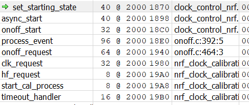

I am using a custom board that uses Arm Cortex-A7 and embedding an nRF52840, There is no external low-frequency crystal 32kHz connected to the nrf52 chip, so I've enabled the internal RC by
CONFIG_CLOCK_CONTROL_NRF_K32SRC_20PPM=y
CONFIG_UART_CONSOLE=y
in prj.conf and added nrf52840dk_nrf52840.overlay to my project.
&uart0 {
	status = "okay";
	current-speed = <19200>;
	tx-pin = <6>;
	rx-pin = <8>;
then compiled direct_test_mode example and flashed it using j-link. the custom board starts booting up continuously and showing the below message:
*** Booting Zephyr OS build zephyr-v2.4.0-198-ga4ead9805140  ***
Starting Direct Test Mode example
P0.31 set to high & P0.2,P0.29 set to low.
ASSERTION FAIL [r >= 0] @ WEST_TOPDIR/zephyr/drivers/sensor/nrf5/temp_nrf5.c:61
E: r0/a1:  0x00000004  r1/a2:  0x0000003d  r2/a3:  0x00000001
E: r3/a4:  0x00002761 r12/ip:  0x00000000 r14/lr:  0x000043eb
E:  xpsr:  0x61000000
E: Faulting instruction address (r15/pc): 0x000086c0
E: >>> ZEPHYR FATAL ERROR 4: Kernel panic on CPU 0
E: Current thread: 0x20000410 (unknown)
E: Resetting system
Any suggestions to solve this issue?
