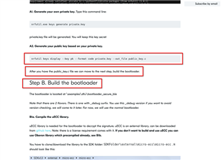

  • also did you following the following steps?
    You have to make sure that you rebuild the bootloader using the newly generated keys. If not then the public_keys.c file in the order bootloader will not be able to validate the zip you generated with the new keys. If you simply flashed the example bootloader I don't believe it will work with any zip generated outside of those precompiled examples. You need to rebuild the bootloader with the correct public_key.c. This is the main step the make the bootloader secure.
