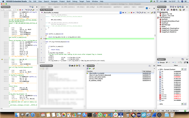

When it receives a Leave Request from coordinator, the Zigbee Stack gets stucked on zb_address_reset() function. Because of that, the Zigbee task remains blocked for the rest of the time.
Which should be the reason to halt at this point and how this could be avoided?

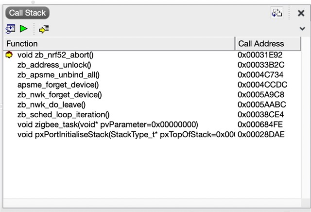

  • Hi Marte, we're still facing this issue even with the new code you provided.
    Please find attached an image with the Call Stack content.
    Device (router role ) was removed from the network.
    When it starts, it automatically joins to the network and periodically prints:
    app: Parent is unreachable
     app: UNKNOWN SIGNAL = 17
    When we press a button to order it to leave network, it sends the leave request:
          /* Set dst_addr == local address for local leave */
          p_req_param->dst_addr = ZB_PIBCACHE_NETWORK_ADDRESS();
          p_req_param->rejoin   = ZB_FALSE;
          UNUSED_RETURN_VALUE(zdo_mgmt_leave_req(bufid, zbm_send_leave_nwk_cb));
    And the callback is triggered successfully. But then the funcntion zb_nrf52_abort() is called due to an assert....
