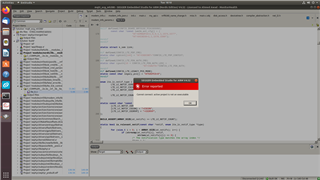

I am getting the Following error after connecting the JLink

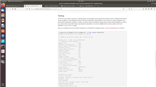

I followed the following procedure
What am I doing wrong? DO I need to install anything else?

From your screenshot, it looks like you have selected "project modules/lib/..." as the active project, which doesn't hold any .elf. Could you try and right click on "Project 'zephyr/merged.hex'" and click "Set as active project" to see if this fixes the issue?
