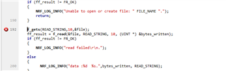

    //f_gets(READ_STRING,10,&file);
    ff_result = f_read(&file, READ_STRING, 10, (UINT *) &bytes_written);
    if (ff_result != FR_OK)
        NRF_LOG_INFO("read failed\r\n.");
    else
          NRF_LOG_INFO("data :%d  %s.",bytes_written, READ_STRING);
    (void) f_close(&file);
    return;
Quastion 1 : I have seen other threads but no help regarding reading file. Can you check if i am missing anything.
Quastion 2: I have a file with multiple lines, where i want read line by line by using f_gets(). But it shows error when call functions like f_gets() or f_printf in fatfs example code
It says undefined reference. But all other functions are working fine
