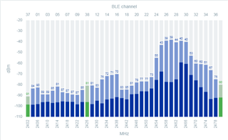

thank you, does RSSI detection can detect all kind of protocol carrier? e.g. there ara wifi, bt, zigbee and others share the one channel, how can I estimate if it could send packages?
what is NRF52810 RSSI detection theory? does it can get RSSI value after received a packge or just sensed carrier in the air?
if it's trying to estimate if is the channel clean enough for a while, should I triggle RSSI_START continuously?
It detects signal strength on channel (the actual modulation should not matter). You can in any case download nRF Connect for Desktop and run RSSI Viewer there if you want to test with wifi, bt, microwave oven or other sources.
You can sample RSSI at any time while in receive mode using the start RSSI task, and you can sample as many times as you want.

there are many Zigbee devices at 2405MHZ, about 200 pieces, but the RSSI seems lower than something at 2454 ~ 2474mhz

RSSI is affected by distance and antenna, so even if you have 100 devices, they may be so far away that they will not interfere (even if you are using the same frequency).
Also have in mind that the time on-air is typically so short, that even if you have multiple devices using the same frequency, you will be able to communicate. Typical example can be BLE and advertising. Even they all use the same advertising frequencies (up to 3), you are able to see and connect to a device that is advertising.
