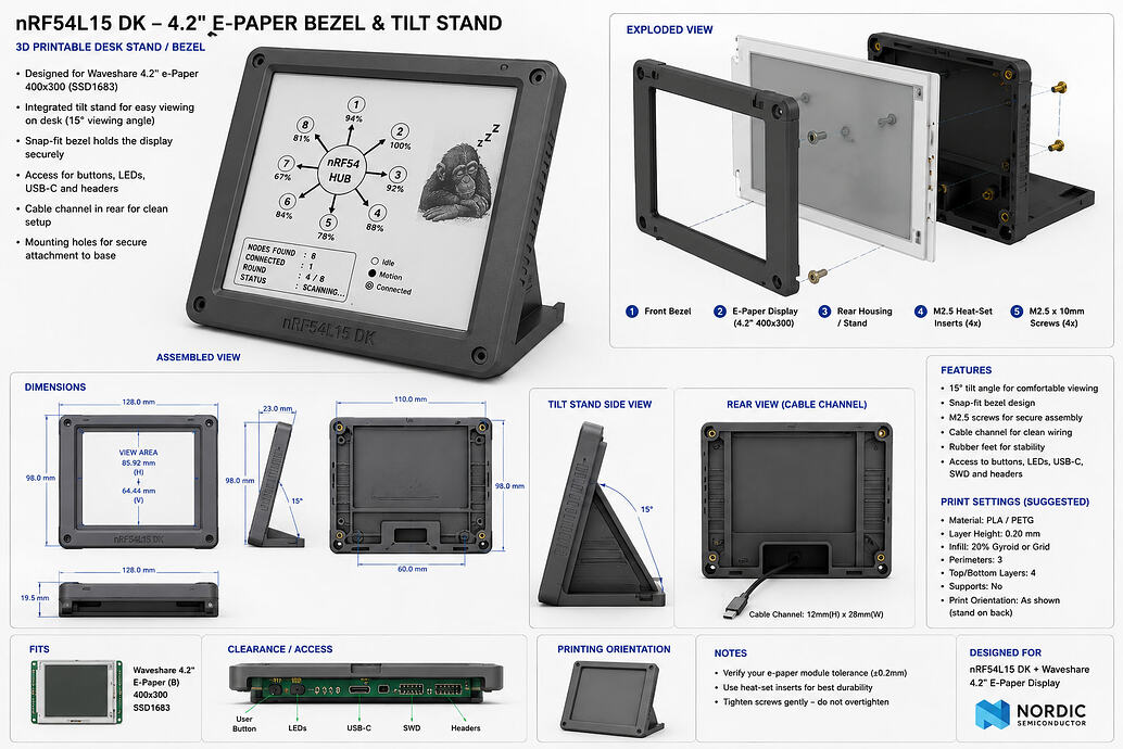

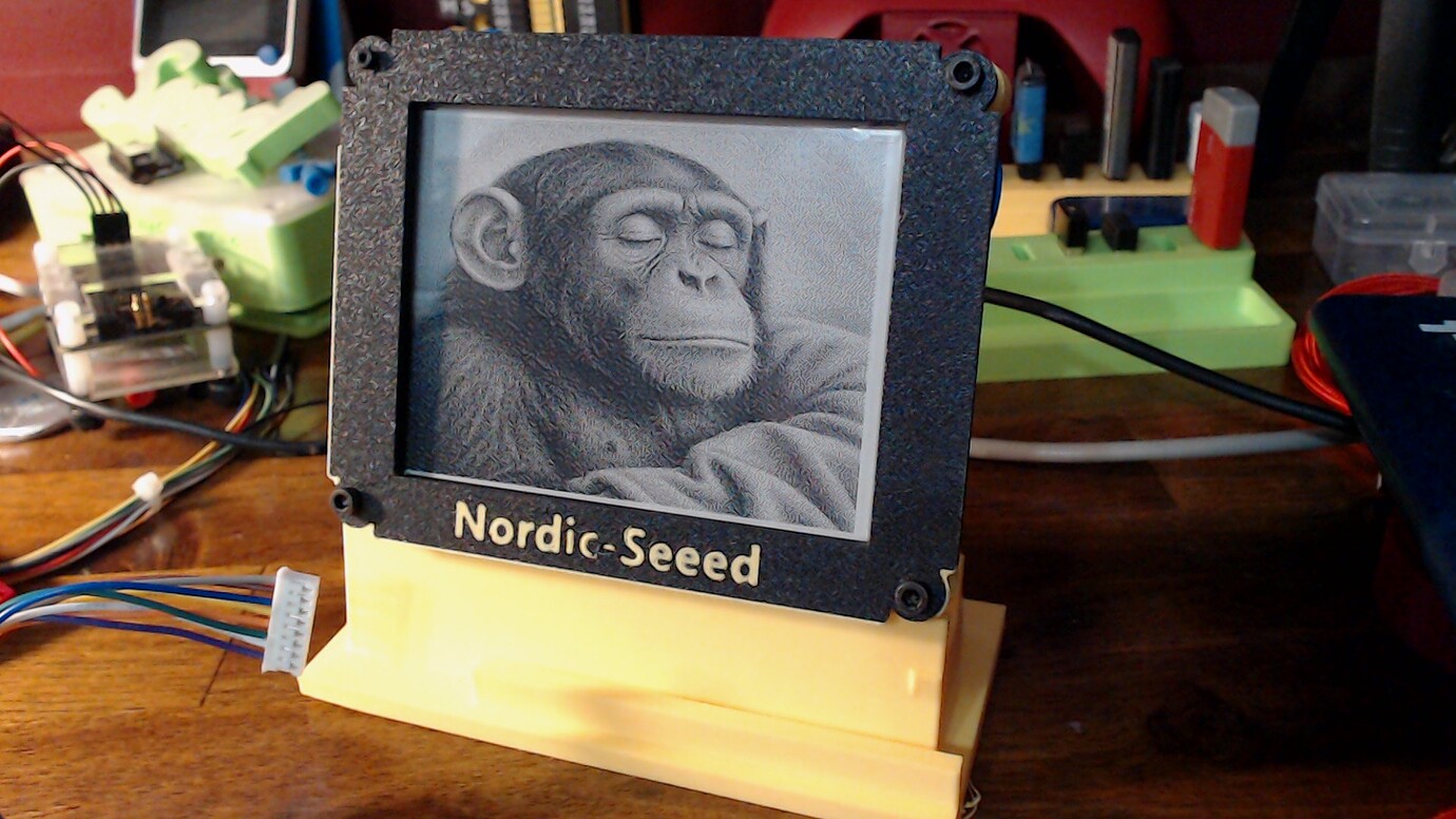

Did you ever manage to get the software/HAL driver code they provide?
added the Stand...
HTH
