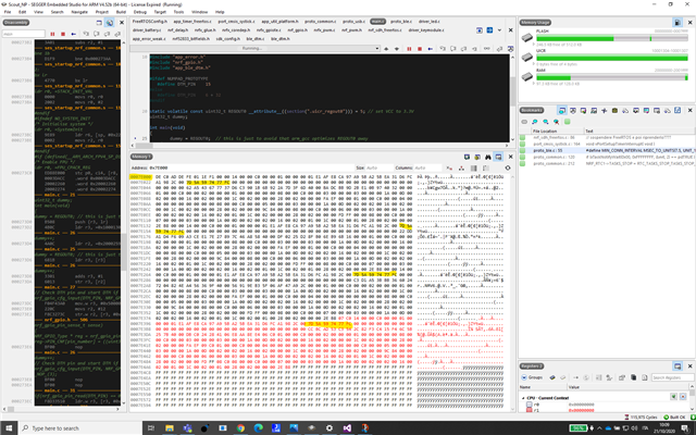

after doing some ble bonding between an nRF52 device and an host computer, I can see this situation in device flash. So, these bonding infos are written
sequentially. How many are available? What happens when there is no any more room? Driver is then starting using entries marked as "not used" again?

    Bonding info along with GATT cache data is written by peer manager to FDS storage space as a set of records - if you're curious, the format of FDS record itself can be found in components/libraries/fds/fds.h. The highlited block of data is not a single record but a sequence of different ones - see components/ble/peer_manager/peer_manager_types.h.
    As many as you have space in FDS.
    Peer manager will initiate a garbage collection procedure - the whole flash space will be compacted by throwing away old records marked for deletion. If there's really no space (FDS is full), it's not surprizing that bonding info will not be saved.
