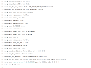

NRF_FSTORAGE fails to write/erase during update in Bootloader with two update options. BLE and GSM.
SDK 15.3
SD S340
Bootloader implemented to update over GSM and BLE. BLE update code is taken from example secure_bootloader_dfu*. GSM update code is custom made. SDK is modified to choose which method to use by writing magic numbers to GPREGRET register.
The problem occurs when DFU tries to erase and write old settings. However, when one type of update works, the other does not, also it looks like to be dependent on sdk_config.h settings, particularly:
Having choose FSTORAGE_NVMC to 1 and define BLE_STACK_SUPPORT_REQD updates successfully over BLE, but fails with GSM update.

#ifndef FDS_BACKEND
#define FDS_BACKEND 1
Changing FDS_BACKEND to 2 and removing BLE_STACK_SUPPORT_REQD, enables successful update over GSM, but BLE fails.
Failure pattern, when GSM fails
Failure pattern, when BLE fails
Parents Reply
  • Ok, looks like Softdevice was not enabled in my custom implementation, that explains why NVMC backend worked. Now flash erase/write works.
    But the custom update implementation that used NVMC before seems to be blocking, and now when flash operations go through SD it seems to be asynchronous, and my bootloader goes to inactivity, because it does not get an event.
    How can I track  nrf_dfu_flash results by polling or with some feedback? See picture.
