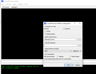

  • You can use Segger's RTT viewer, which is probably already installed if you have downloaded Segger JLink. If not, you can either download Segger JLink.
    If you started out with the ble_app_uart example, then the issue is probably that you are already using the UART when you call log_init(), and then later, when the application tries to initialize the UART which is used in the application, it returns an error. Since this is before you get the time to print much in the log, before it resets, you see this behavior.
    Try to get the RTT viewer up and running, and see if it helps to disable the UART log backend.
    FYI, when you run the RTT viewer, you should set it up something like this:
    BR,
    Edvin
