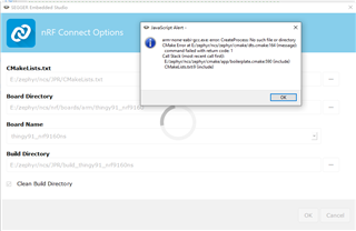

1. When I loaded the 9160 project, I had problems,
arm-none-eabi-gcc.exe:error:CreateProcess
9160 development environment, the required software, I have installed and verified, why I load the project, prompted an error, there is no arm    none EABI- gcc.exe : error:CreateProcess
think you!

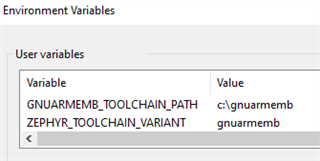

    Did you set the environment variables correctly? You should add the following to your environment variables:
    • ZEPHYR_TOOLCHAIN_VARIANT = gnuarmemb
    • GNUARMEMB_TOOLCHAIN_PATH = c:\gnuarmemb (the path to your GNU Arm Embedded Toolchain installation, which is usually c:\gnuarmemb)

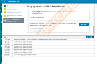

    If this doesn't fix your problem, please try to install the SDK and toolchain using the toolchain manager, as the getting started assistant is deprecated.
