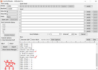

When receive the following data from the app, each LED timer is output.
1 : Left LED Timer Start
2 : Right LED Timer Start
3 : Crush LED Timer Start
4 : Crush LED Timer Stop
Left and Right timers are stopped after running for a certain period of time.  The Crush timer continues to run. (can stop by sending data from the app)
If the app sends '1' to run the Left timer and sends '2' to run the Right timer before the Left timer completes, the Left timer stops and the Right timer runs.
This is almost going well. However, when you stop a timer that is in operation and run another timer, the other timer is initially run twice.
Can I know the reason for this?
